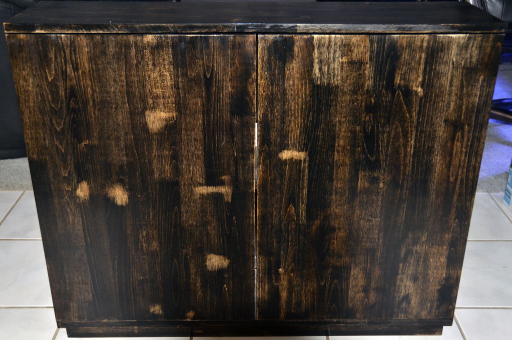

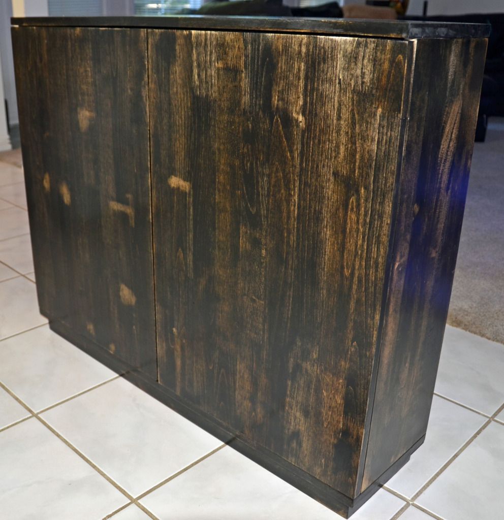

    Here are a couple shots of the Mr. Aqua Stand (not my photos)
    While I like the minimalist style, the fit and finish are lacking. The stand requires a lot of filling and sanding prior to finishing to come anywhere near furniture grade. There are many finger joints visible hence my use of ebony stain....
    The Mr. Aqua stand required so much finish work, I would have been far better off building one from scratch (not to mention the missing hardware.)

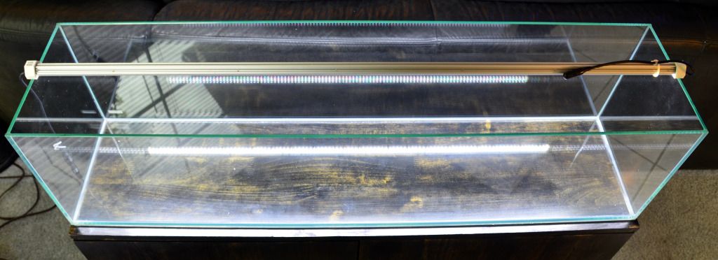

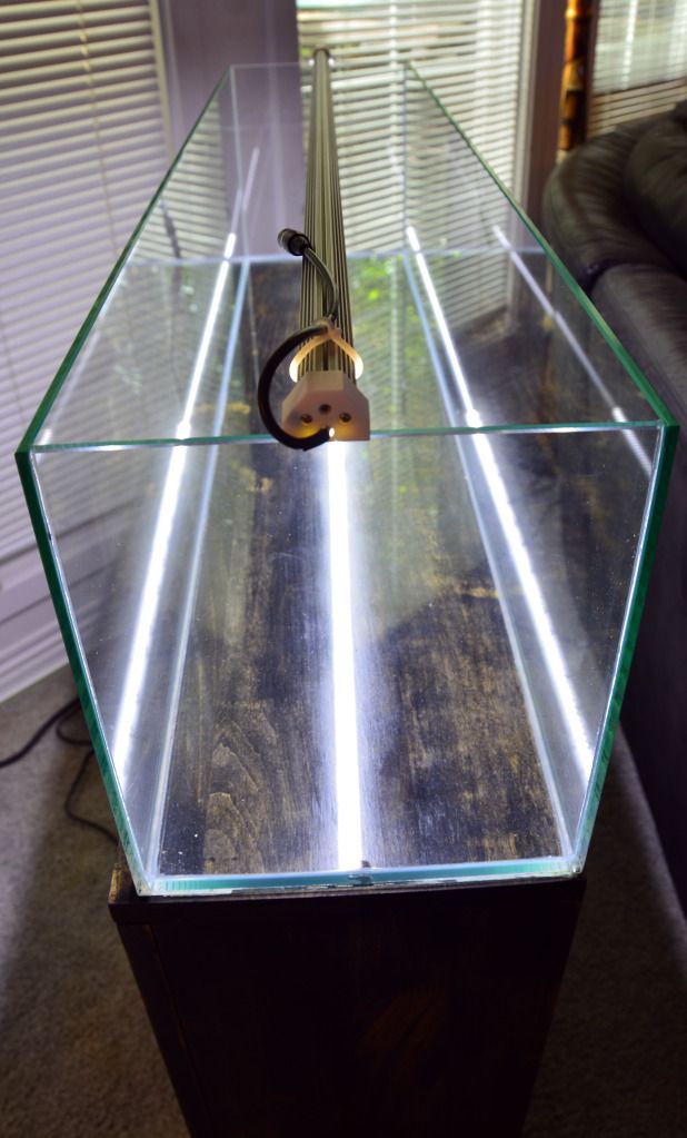

    I only had a few moments, but I put the tank on the stand, grabbed a few quick photos and PAR measurements. I'm very pleased with the results. My guess at PAR was pretty close. If needed (largely depending on the aquascape) I can dim these to lower the PAR output. The quality of the light is better than I had expected.

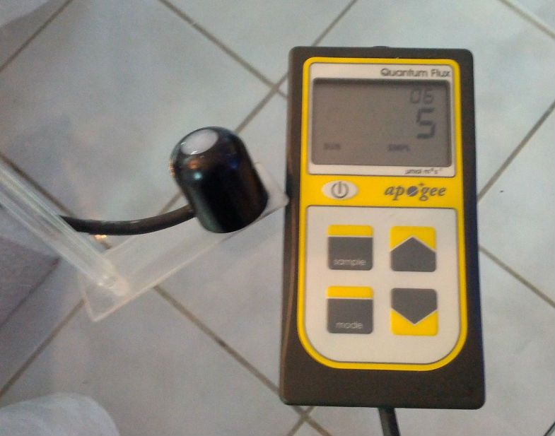

    I used an Apogee MQ-200...
    These PAR measurements were taken in "open air". Based on my experience, they will differ little when measured with water in the tank. The fact that these lights use surface mounted emitters without any optics might provide different results through water - I'll remeasure once the tank is wet.
    I Moved the the stand to the garage for a few days to allow it to "outgas" The fumes from the oil-based stain and Helmsman were still a bit much.
    I don't like the way the black power cords are so noticeable on the TrueLumen Pro - especially since the fixture itself mostly disappears. I'm painting the the docking brackets white and ordered some vinyl stain to make all the exposed parts of the cords (above the black stand) white and hopefully less noticeable.

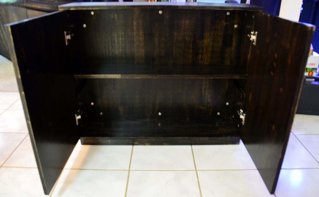

    One other observation for anyone considering the the Mr Aqua stand - It has a very small interior with only ~7" usable depth. It will take some finagling just to get the 2215 and it's water lines in there. A few shots of the completed stand. The finish has a "tortured" look to it - Just image the resulting offspring if a black-lacquer baby grand piano mating with a wooden shipping pallet...
    Yup, that pretty much describes it
    The shelf has to be removed in order for the 2215 and 5# CO2 bottle to fit. While this is not a type of finish I would have normally chosen, somehow it seems appropriate for a Wabi-Sabi style cabinet. The shelf has to be removed in order for the 2215 and 5# CO2 bottle to fit. While this is not a type of finish I would have normally chosen, somehow it seems appropriate for a Wabi-Sabi style cabinet. The only somewhat disappointing part is that many hours or work went into creating this and it ends up looking like it was made from a left-over shipping crate
