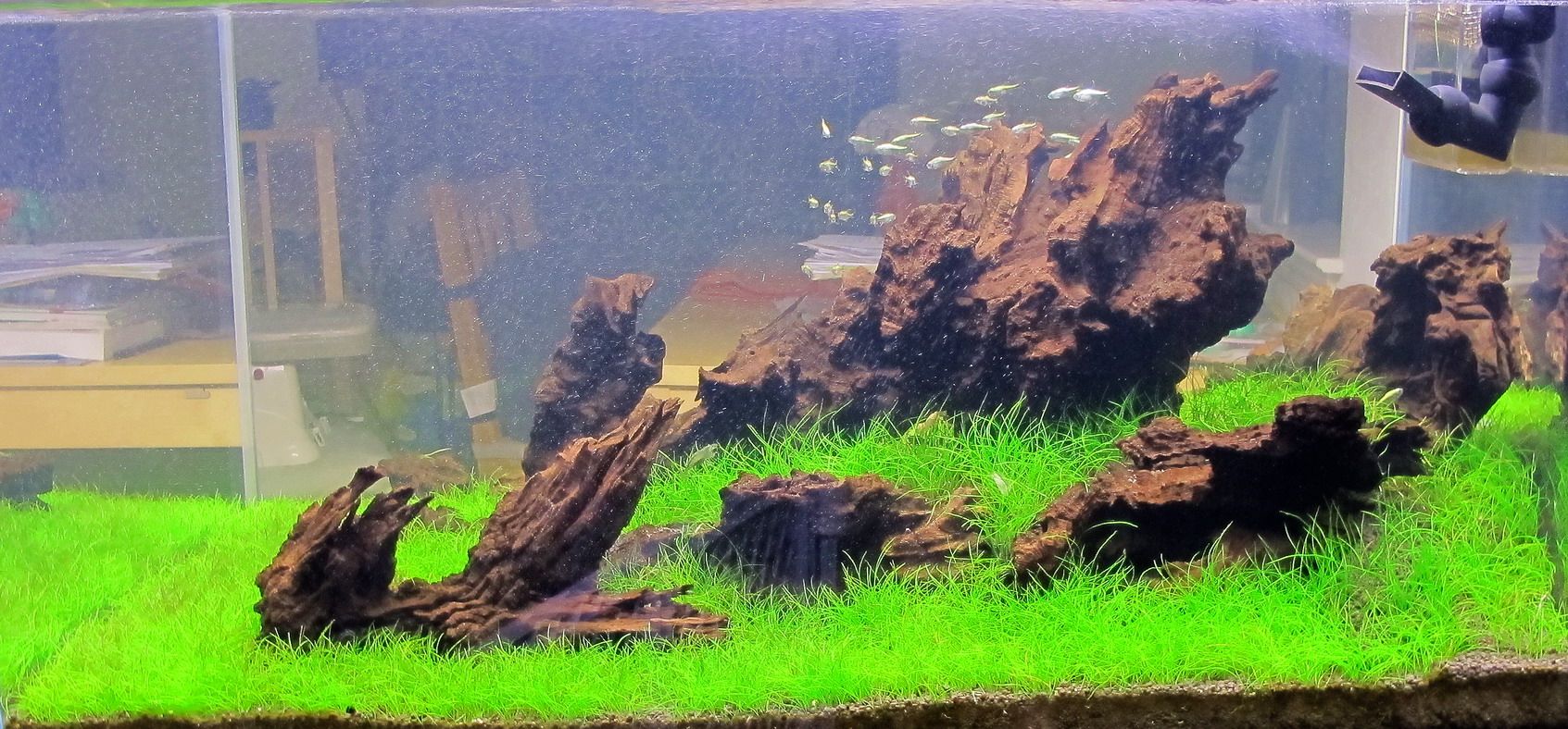

    I change the water monthly on this tank:
    the water change frequency and amount.
    Plant biomass is much lower than many other tanks, so I dose about 1/3 EI. This is a VERY easy tank to care for.
    Once a month water change. No trimming really, I'll cut a sod piece and sell it once every 2 to 3 months but that's about all.
    So the aquariums can look very nice and easy to care for using this reduced water change method.
