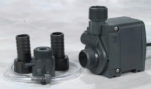

            Question: if using this pump inline with Eheim canister, how/where do you connect the CO2 line?
              There are two ways to connect the CO2 tubing.
              First way: Look at the part in front of the two barbed fittings. It has a place on the side, like a small tube sticking out, where the CO2 tubing connects.
              Check out part #10 on page 2. It is a diagram that shows the tubing connecting part. You can't see it, but the tubing connection forms a venturi on the inside: http://www.eheim.com/files/image/1103_Anleitung.pdf
              From the 3Reef link above. You can see this part when it is connected to the intake of the pump.
              Second way: Another way to connect it is to omit this part and use an Aqua Medic 15mm x 4mm Reducing Tee. You connect the filter's 16/22 mm tubing to each side and the CO2 tubing to the 4mm part of the Tee.

                      Left C I have a Eheim 1103 Compact+ Marine Needle Wheel Pump for quite some time now. When I used the pump, it worked very well however I remember Jart was having a problem with his. I think he finally realized it was the way he connected the pump that was the culprit.
                      I've been gone a while but ready to get my 45C (18x18x18) up and running. I'll be using the pump with this tank as well and once its up, I'll post picks of it in action. Here are some photos of my pump:

                        I did make a mistake when I installed it. I overtightened the intake part where the tubing connects and cracked it. I ended up using an Aqua Medic 15mm x 4mm x 15mm reducing Tee that I had laying around instead. This works fine. I feel like a dummy for overtightening it. I just wanted to give everything a final twist to make sure that everything was good and tight.
                        This is the part that I cracked. It is from dantra's photos above:
