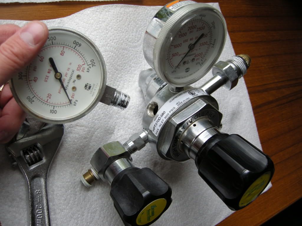

    Here is my HPT270 as it came from ebay:

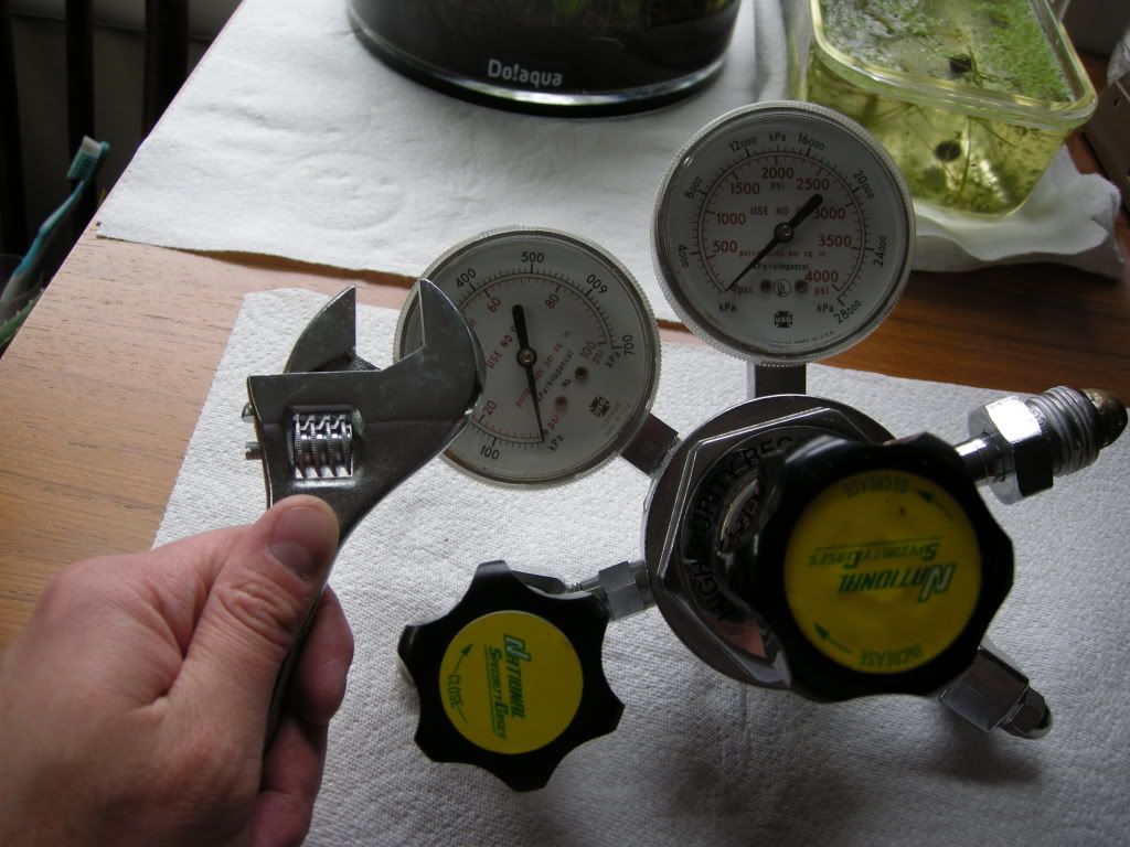

    First step if you have oversized gauges (like the HPT270) if to remove teh gauge to prevent damage during disassembly. For this I used a regular wrench and some arm strength:

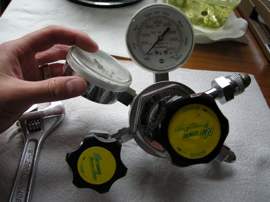

    next remove the valve on the left where we will attach the post body components. I used the same wrench:

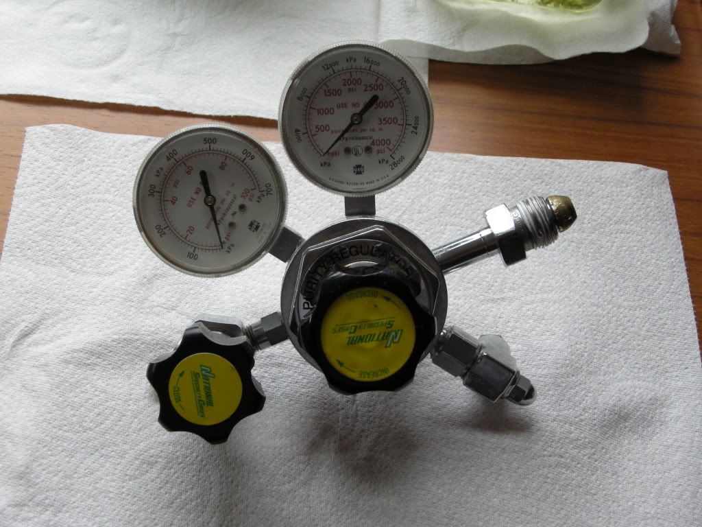

      The final stage is to remove the GCA 580 nut and nipple. For this I used a Vice Grip and some arm strength. This is where we will connect our CGA 320 nut and nipple, which will mount to our CGA 320 adapter on the CO2 tank.
      See pics:
      Here I began to install all the parts loosely to prevent crud from getting in the regulator while I wait for parts!
