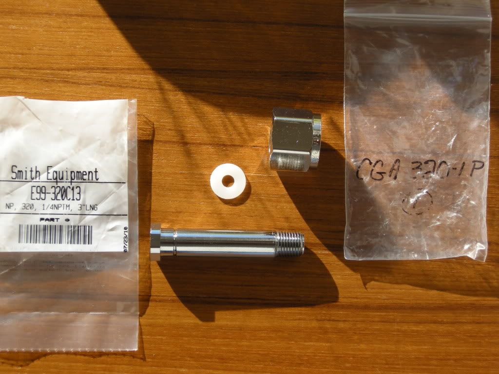

    I bought the Chrome SMith CGA-320 nut and nipple from the link in post #1.
    I'll let the pictures do the talking, but I will insert text when there is something to add.
    it arrived via USPS flat rate:

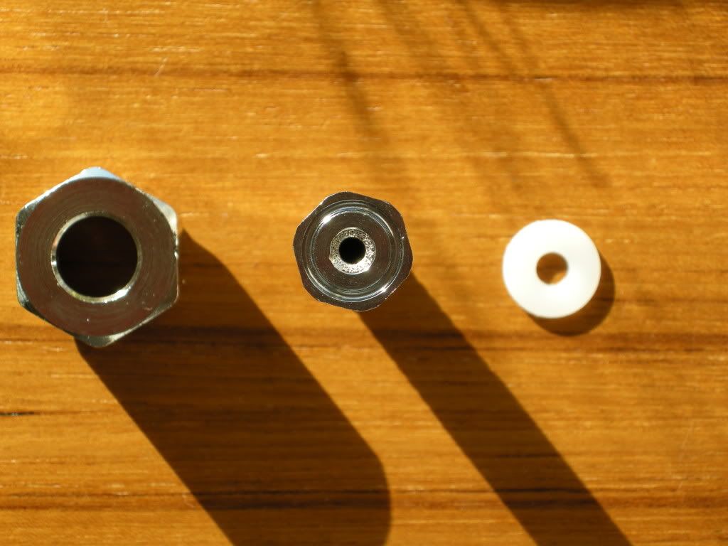

    First step, gently slide the nut on the nipple with the threads of the nut facing out over the nipple. (self explanitory...LoL).
