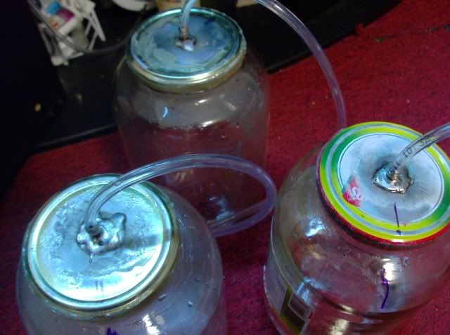

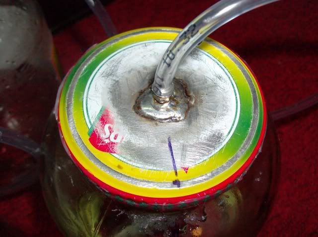

    Firstly, I needed to completely resolve the plastic leaks caused by air hose hardening at the bottle entryway and this is what I’ve done. I went to Canadian Tire and purchased 3 brake caliper bleeder valves and soldered them into very tight holes in the steel pickle jar lids (no more silicone). I tested all three under water. I put a tube on the valve and pumped air into the bottle with a bike tire pump until the lids started to really bulge, not a single air bubble leaked. The bottles are air tight! Problem solved.

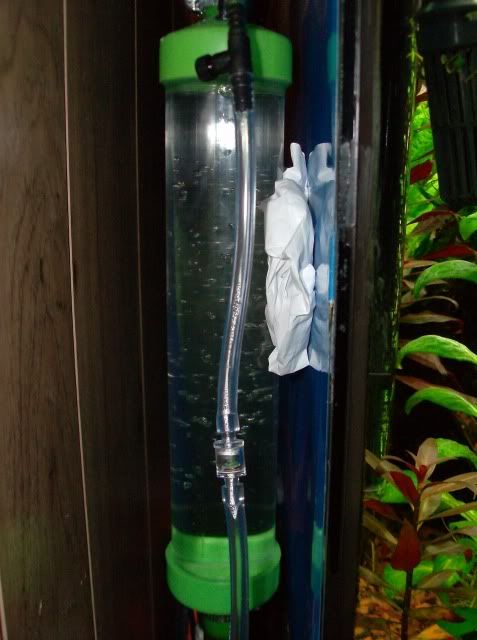

    Then onto my diffusion issues, but remember I needed to solve my problem cheaply. The bleeder valves only costed me about 6 bucks. I thought about it and thought about it and then decided to take a little break. While doing some tank clean-up with a small amount of gravel vacuuming I got an idea when watching little bits of gravel fight against the pythons current. If I were to buy another 10” Python I could use the second cap to create an inline diffuser! Diffusion solved…..I hoped!

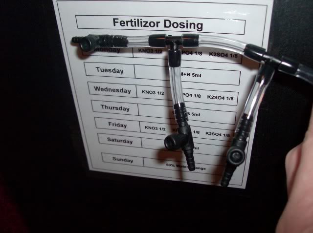

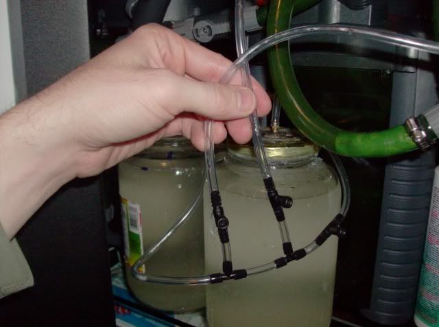

    I also wanted to create an easier way the remove and replace the bottles while at the same time introducing as little oxygen to the system as possible. I also wanted to minimize tube flex from pressure. I used this really thick airline hose I found a Canadian Tire (twice as thick as the airline at Aquarium Services) really heavy duty stuff which is also supposed to be resistant to corrosive chemicals. I rigged up a series of valves to help lock in as much Co2 in the system as possible while changing bottles.

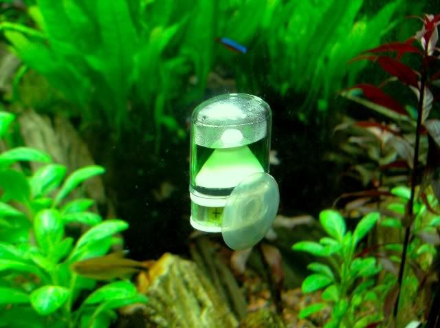

    I thought possibly because Co2 is heavier then air that is was just slowly pushing the air out first. In fact, I believe I was close to jumping of a bridge if this wasn’t the case! LOL Anyway, sure enough, just a few hours after 36 hours had passed I started noticing the drop checker changing color. It changed fairly quickly too, within about 2-3 hours it turned a nice dark green, right around 10:00PM. The next morning it was a nice light yellow green and seems to be holding. I look forward to seeing what happens after 1 week and I have to change a bottle. I have my current mixture lasting just over 3 weeks.

    When I cleaned and reset-up the drop checker, I set it up with a “5dkh” solution. I figure if I can get yellow-green with a 5dkh solution then I can be even more assured that there is at least 30ppm Co2 in the tank.
    First day

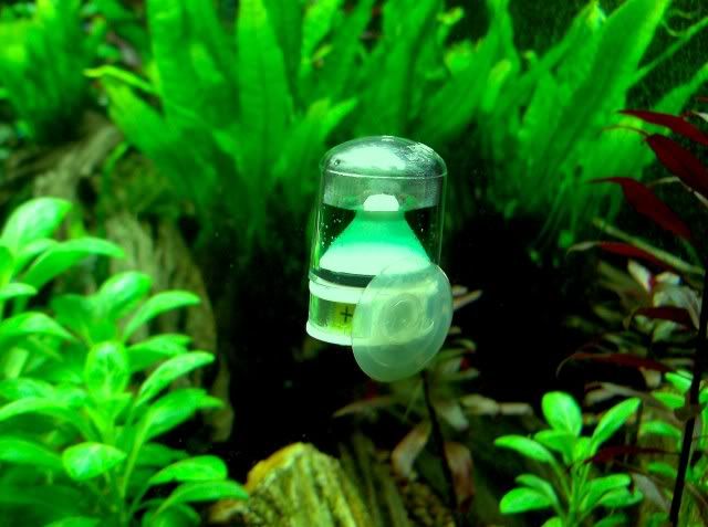

    36-38 hours later, at 36 it still looked mostly like the first picture….then,
    Next morning and now 2 more days in and the color is holding at a nice yellow green,

    What did you use to glue the extra gravel vac cap on with? Did you have any trouble getting the cap off in the first place?

      I had no issues at all getting the cap off, they are not siliconed or glued in any way. On there own they fit real tight and do not leak but I decided to silicone the caps in place, just in case. If the damn thing came apart it would empty near half the tank onto the floor and my wife would not be impressed. LOL
      Another great thing about the diffuser is that when I do get the pressurized set-up I can plug it right in to this one.

        Just had a thought... It might be worth while hitting those jar lids with some clear-coat spray paint to keep rust at bay. I'm pretty sure they aren't stainless. Tape off the inside rim though so you don't mess up the way it seals to the jar.
          Thta's great idea! Thanks, i have some black I can put on it.
