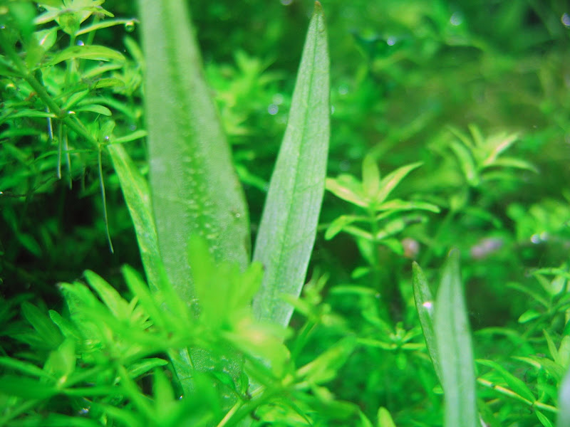

    I've had problems with plants growth for some time now.

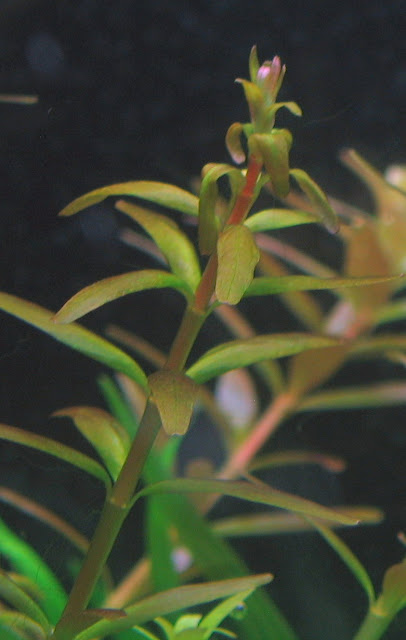

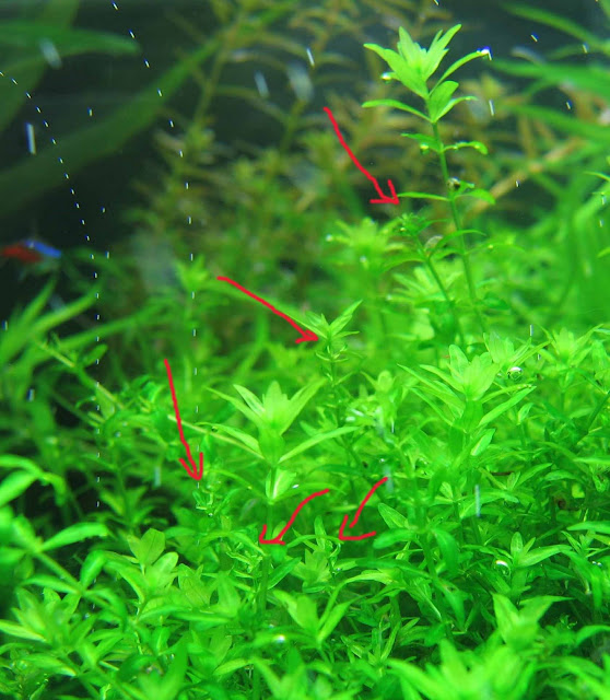

    Rotala macrandra, rotoundifolia and hemianthus micranthemoides have twisted tips.
    Sagitaria Subulatta still shows interveinal chlorosis.
    Hygrogophilia angustifolia has brown leaves.
    http://lh6.ggpht.com/_dui4kzd4O4A/SX...0/IMG_5189.jpg click on the link

    Did you encounter such symptoms and find their cause ?

    Those are still classic poor CO2 symptoms, smaller progressive tips and stunted tips.
    Few things will do that.
    Low NO3 might be the only other thing.

        Yours symptoms resembele mine. I've had stunted tips of H. micrathemoides and they looked tha same.
        My current pH measurement also shows 6.5 and my KH is 6.7 (water dep. info). This means I have 63ppm CO2 and also shows that my readings are NOT reliable (fish are fine).
        My problem solved increasing NO3 daily dosage.
        You said you've increased CO2 to the lethal levels. Have you increased NO3 also at that time?
        I think you have low levels of NO3&CO2. Both might be at limiting levels.
        Adding more NO3 you get stunted tips because of CO2 becoming limiting factor and vice versa.
        Leaner NO3 => lower CO2 demand - better (but not best possible) growth in your case.

                      Also, I'm not sure why some Rotalas Rotundifolia that grow side by side don't show such symptoms. Most often some of them are twisted but others grow properly.
                      This is the smoking gun..........
                      So's the pearl weed...........

                            I have and can dose these same ppm's of nutrients and do not have such responses from plants. Give these two things, even without a CO2 ppm reading, I know and can falsify that it's a nutrient issue, rather, much more likely a CO2 issue. I've heard this and seen before many many times, and had plenty of folks say the same things that you have here, this is not a new issue you alone have seen.
                            It is easy to rule out nutrient causes, we know what they are.
                            They are much easier to test.
                            You can also make reference solutions and should, to show that the test readings for the ppms are correct as well as knowing you have at least the ppm's based on adding a known weight to to a known volume of water.
                            We can measure light pretty well.
                            This just leaves CO2 as the main variable and it's not as easy as you seem to think to measure it confidently. You are not going to get anywhere and get at the root issue here until you address that.
                            Plants grow well for only a few reasons/variable, CO2 light and nutrients.
                            As long as filters are clean, etc other basic stuff(often these can be over looked), those are what you have to work with. I have these same plants and do not have these issues unless the CO2 tank runs out. Then I get similar issues on the same species at the client's. Light and Nutrients are/where the same, only the CO2 changed. Smaller stunted tips, if it's strong CO2 issue, then BBA, some species melt, some stunt, BGA maybe, Hair algae etc. It's not hard to add a bit more CO2 and dose and do large water changes for the next 2-3 weeks or so. Then you can see.
                            You have wide ranging issues in the tank with many species and then only some plants. What else could do this?
                            I know of nothing.
                            And if the plants had been doing fine, prior, and you did "not change anything", then it's virtually always going to be CO2.
                            Nutrients can be added and stabilized easily. CO2 not always.
                            Also, as plants grow more, more biomass they also have more CO2 demand from the water. If CO2 is slightly limiting, then some will grow well, others will stunt.
                            As you add more biomass, you end up with some stunted, some not.
                            The plant sacrifices some so that the others will grow and hopefully make it to the top and flower etc.
