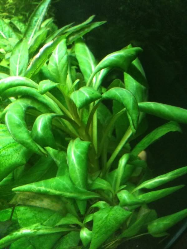

    I have a 29 gallon tank with 72W of T5 NO lighting. I inject CO2 though a reactor and measure it with a 4dKH drop checker - by midday my plants are usually pearling and the drop checker is lime green. Normally I dose Pfertz 3X weekly at the recommended dosage. All was going very well for over a year. In the past few weeks my LOBELIA CARDINALIS and even staurogyne repens has taken a turn for the worst - they look almost wilted and started taking on a lot of GSA. My inclination is a phosphate deficiency. Any thoughts?

    Have you been increasing c02 and ferts to account for the increased bio-mass over the last year?
    You have a good amount of light for such a small tank...If the plants are now more dense, and c02 remains the same, you will have issues.
    I would look to your ferts and c02. BTW, a drop checker is not really an ACCURATE c02 measurement...plus the 2-4 hour lag time...it is really fairly useless
    More details on the tank? Substrate, more lighting details (# bulbs, temp, etc).

        The substrate is 50/50 mix of EcoComplete and ADA Aquasoil. The lights are T5NO, there are four of them each are 18W. They are all the 6500K Coralife bulbs.
        As for increasing CO2 and ferts, I have been slowly increasing the CO2. This really helped with algae issues and growth issues in the past. I've been fairly consistent dosing the Pfertz line - 1 pump/5gal after a 60% weekly water change, and 1 pump/10 gal ever other day thereafter.
        The Pfertz line is pre-mixed. There are four bottles in the product line. The bottles are N, P, K, and micros. www.pfertz.com. I also dose Excel at water changes (3 capfuls).
        What I don't get is everything else I the tank looks good - the problem is mainly confined to the cardinalis. And it really happened after I divided up the mother plant to propagate.

          The Lobelia cardinalis pictured in your original post does not appear to be the Lobelia cardinalis “Small Form” (the leaves would be rounder), which is a bog plant that can spend a great deal of time under water.
          Your plant appears to be the Lobelia cardinalis L. spp. that will survive underwater for a while then die, it is a pretty plant, get it out of the aquarium and outside or in a pot.

            This looks more like a CO2 issue, not Nitrogen or other things.
            You can dose more pfertz and easily rule out ferts as long as they have everything in them the plant needs etc.
            Then it's just CO2, but I've had a lot of Lobelia in the past and found it very easy and forgiving, when....... good CO2 was used.
            If other plants have smaller tip growth, then you can bet it's CO2.
              I am positive that the plant I am calling "L. Cardinalis" is an aquatic plant. I've had this one for over a year and a half and have had this plant before in the past. The leaves are small and round - they are just curved and folded under due to whatever problem I am having. Usually, like Tom said, it is a forgiving and very undemanding. Which "flavor" of cardinalis and the exact Latin name, I'm not sure.
              Would you recommend EI dosing rather than using the Pfertz? Tell me, I can handle the truth....
              When you say "good CO2", do you mean that I have too little or too much? Some of the other plants do appear to have slightly smaller new tip growth.
              Doesn't the increased GSA implicate a shortage of phosphate?

                GSA suggested either or both PO4 and CO2 is poor.
                PO4 is easy to rule out after 2 weeks of good dosing.
                So this leaves you with........CO2.

                      One drop checker with 4dKH can read anywhere from 18.9 and 47.5ppm CO2 depending on which shade of green you're able to discern.
                      Some indicators of low levels of CO2 would be GSA and stunted or slower then normal plant growth. Garry may know some more.
