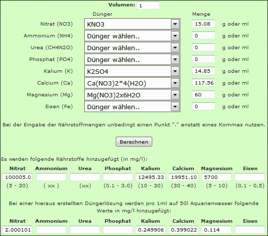

    Well, that is sorta how my new NO3 fertilizer looks.
    (Very) partially based yet fully inspired by the AR Makro Spezial N fertilizer, but without urea.
    I have dilluted the following chemicals into 1 liter:
    KNO3: 15.08 grams
    K2SO4: 14.85 grams
    Ca(NO3)2*4(H2O): 117.56 grams
    Mg(NO3)2*6(H2O): 60 grams
    This gives me, when adding 1 ml of this solution to 50 liters of water:
    - 2 ppm NO3
    - 0.25ppm K
    - 0.4ppm Ca
    - 0.115 ppm Mg
    p.s. i am not German, but the calculator i used is

          What is your suggestion? What could happen/allready happened then in my mix?
            Bio may have gotten this one wrong
            it is not the Ca&Mg but the sulfate.
            @Tug should be no problem getting Ca(NO3)2 in solution as something like 130g to 100g H2O
              Figured something like that. This morning i had about 1cm of goo in the bottom of the container which would not dissolve. Is this the Sulfate reacting?
                p.s. how about Calcium chloride or Calcium citrate, this is chelated right?
                  Try it w/out the K2SO4.
